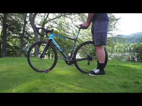

Instead, Swanson and his team claim to have increased compliance primarily through the use of the D-Fuse integrated seatpost in the two Advanced SL models, a design originally used in Giant's top end TCX cyclocross bikes. The thin D-shaped post is claimed to add 12mm of ride-smoothing flex, but have no effect on power transfer. Once cut, there is 25mm of adjustment, which Giant feels is adequate to alleviate concerns about resale, a common complaint leveled at integrated post designs. However, that doesn't solve potential problems of travel or test rides.
2015 Giant Defy Endurance Bike 2015 Giant Defy Endurance Bike
The new Defy uses two forms of its ride smoothing D-Fuse seatpost. Top end SL models utilize an integrated set-up, while mid-tier bikes have an integrated seat clamp.
The rest of the composite frame models use a more traditional seatpost binder that has an expander bolt easily be accessed at the top tube. Swanson says the ride characteristic of the two systems will vary some, and the non-integrated posts are less stiff and a little heavier.
All the new frames also utilize dramatically thinned compliance-enhancing seat stays, which attach lower on the seat tube. Ride feel is further enhanced by the stock 25c tires, and Swanson says 28s are no problem.
"The stays are basically as thin as we can possibly make them while keeping them hollow," explained Swanson of the leaf spring design. "By keeping the stays hollow and eliminating the need for a brake bridge, we get vertical compliance without sacrificing stiffness. Lowering the junction point gives the frame balance. The upper half of the bike is compliant, the lower half maintains stiffness."
Check out the video below to see the integrated seatpost in action.
