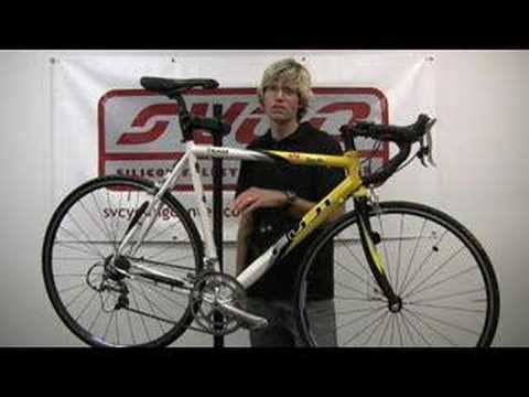

Alex from Silicon Valley Cycling Center continues our series of intros to power meters by giving a brief introduction, the Polar CS600 with Power and heart rate.
The CS600 measure power by using the Power Output Sensor W.I.N.D. direct from the chain, unlike other models that use the crank or hub. This precision system combines measures from two key factors: chain tension, (using a sensor on the chain stay) and chain speed (using a sensor on the rear pulley.) The polar is not only the lightest power meter in the series on your wallet, but it’s also the lightest system on your bike, at a measly 275 grams for the whole system installed. The system retails for $710.

    I don’t believe that the WIND power unit will work properly the way it’s mounted in the picture. The unit has to be much closer to the chain — maximum 3 cm (according to the specs), and the closer the better (according to my experience). If too far, the readings will be inaccurate. If set up properly, though, the unit works well, although it is sort of ugly on the bike.

    I have had mine since October. Never had a problem with it. The 3 cm from the chain to the wind sensor is when the 11 or 12 on your cassette and small chain ring. Mine is about 1 cm when pedaling in the small/small.

    The guy in the video makes it sound like it’s easy to properly set up. It’s not, but it can be done, though with little help from the included directions. Once set up properly, it works well. As one person mentioned, the first-round production of sensors had power/cadence dropout problems. Call customer support, and they will replace.
