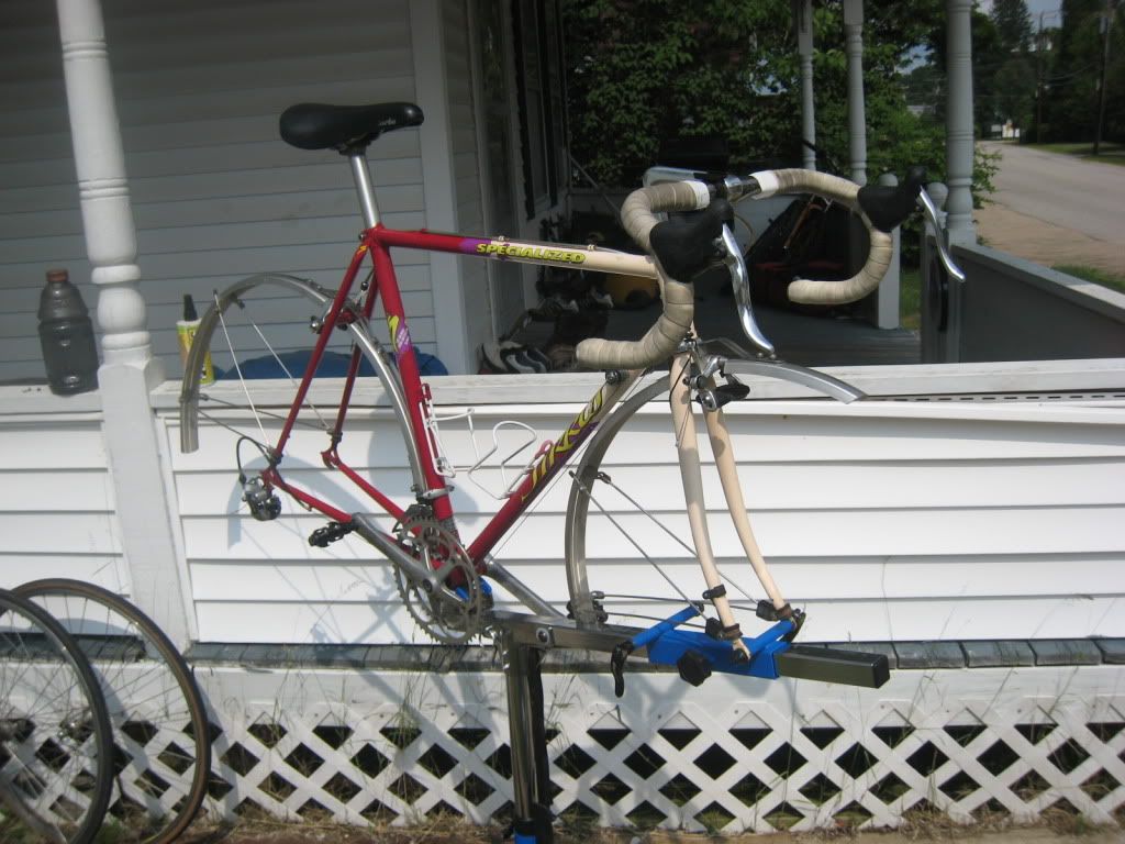

I'm a bit late, but if you're still interested. Sorry, forgot to put the front wheel in, but you'll get the picture.

Thread is a bit old, but a few questions. I have the PRS20 (21?) picture above. I like it, since I have both steel and carbon bicycles and didn't want to clamp the post.
My problem is that I live in a place where I can't leave the stand set up. When I want to work on my bikes I have to haul it out in the backyard and set it up. The central pipe is not precisely machined so that when I'm pulling it out/sliding it up, it goes...then suddenly catches and hangs up. This usually results in my pinching my fingers or something annoying, in some way. I'm greased the heck out of the pipe, but still happens.
Then it can sometimes be a real PITH to get the pin through the arm.
Once the stand is set up, I love it. Setting it up is a slight hassle. (I use mine exclusively at home, not at races).
