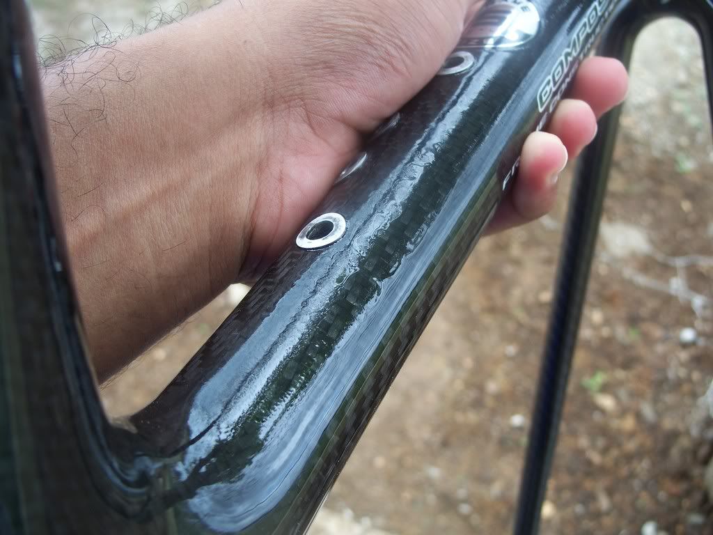

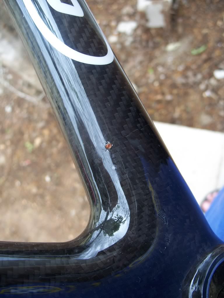

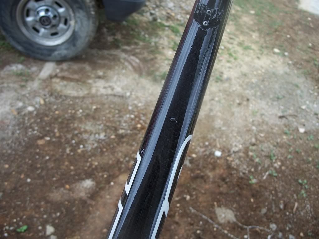

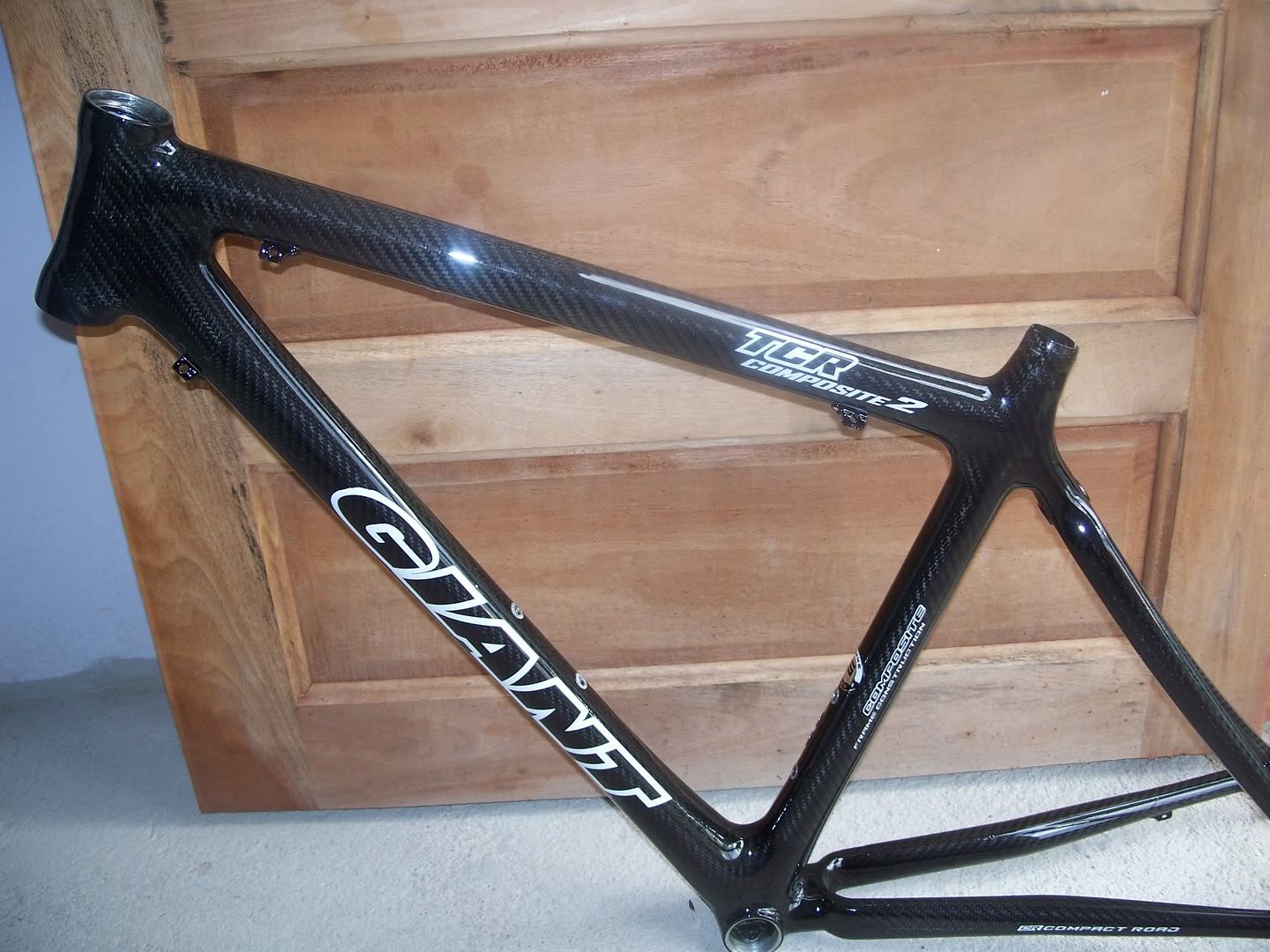

I recently shaved the colored stripes on my 04 Giant TCR C2 leaving only text on the frame. I then took the frame to an auto body shop to be sprayed with clear coat. They reluctantly sprayed the frame and it looks great except for three spots:
near the bottom bracket on the drive side looks like a bug got on the frame while it was drying
on the seat tube the clear coat is a little wavy
on the bottom of the down tube there's a little clear coat run
How do I fix these problems without having to clear the frame over? Is it even worth worrying about since these imperfections will be hidden by the crank, bottle cage, and under the frame? Here's the link to the frame without clear coat https://forums.roadbikereview.com/showthread.php?t=128731

lousy work...
I hope you paid them next to nothing for that botched up job. The lumpy looking area doesn't even look like the clearcoat adhered properly. Either that or somebody picked it up with a rag in their hand before the paint dried. Either way, that would be totally unacceptable to me. Both areas need to be sanded down an recoated.

Thanks for the replies. Most shops in my country don't want to spray bikes because of the weird angles. I've had bad luck with rattle can clears before so I wanted to go another route. I did decide to wet sand the frame and try another shop. Oh, I did pay next to nothing, labor is pretty cheap here, it's the parts that get you.
