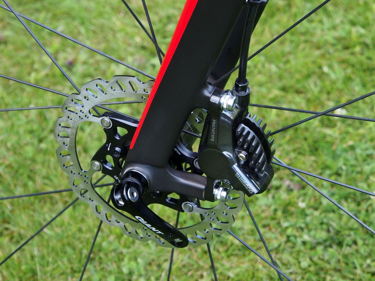

Perhaps more significant is that Giant is going all in with disc brakes, outfitting all eight carbon fiber 2015 Defy models with the burgeoning road braking standard. Top of that line is the wallet-busting Defy Advanced SL 0, which comes stock with Shimano Dura-Ace Di2 shifting, Zipp 202 Disc carbon clinchers, and a $10,300 price tag. If you want traditional rim brakes (and/or to spend a whole lot less money) you'll need to choose from one of five lower-tier alloy models.
The development project started with a basic goal: make a Defy with disc brakes, but add no weight and strike the coveted balance between stiffness and compliance. "This was a purely engineering driven project," said Jon Swanson, Giant's global road category manager. "There are no gimmicks and no fluff. The only thing that did not change between the new Defy and its predecessor was the geometry."

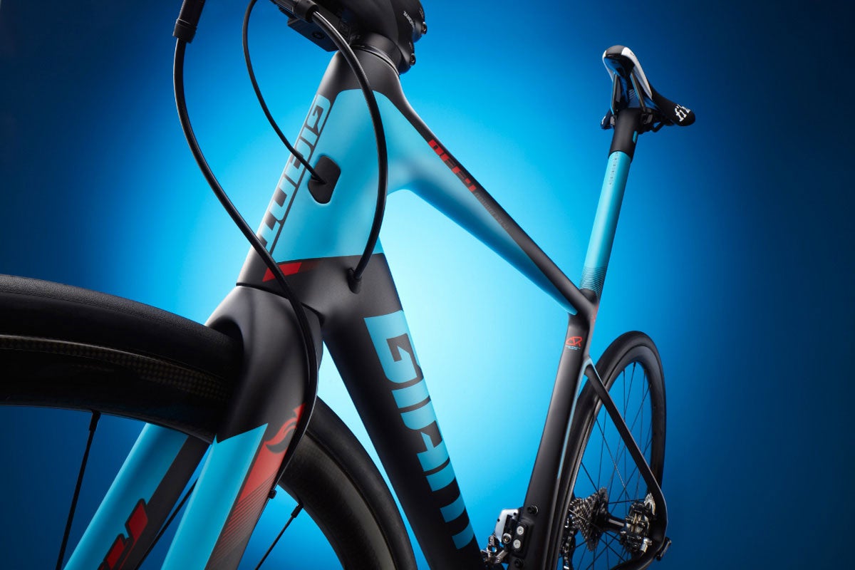

Instead, Swanson and his team claim to have increased compliance primarily through the use of the D-Fuse integrated seatpost in the two Advanced SL models, a design originally used in Giant's top end TCX cyclocross bikes. The thin D-shaped post is claimed to add 12mm of ride-smoothing flex, but have no effect on power transfer. Once cut, there is 25mm of adjustment, which Giant feels is adequate to alleviate concerns about resale, a common complaint leveled at integrated post designs. However, that doesn't solve potential problems of travel or test rides.
2015 Giant Defy Endurance Bike 2015 Giant Defy Endurance Bike
The new Defy uses two forms of its ride smoothing D-Fuse seatpost. Top end SL models utilize an integrated set-up, while mid-tier bikes have an integrated seat clamp.
The rest of the composite frame models use a more traditional seatpost binder that has an expander bolt easily be accessed at the top tube. Swanson says the ride characteristic of the two systems will vary some, and the non-integrated posts are less stiff and a little heavier.

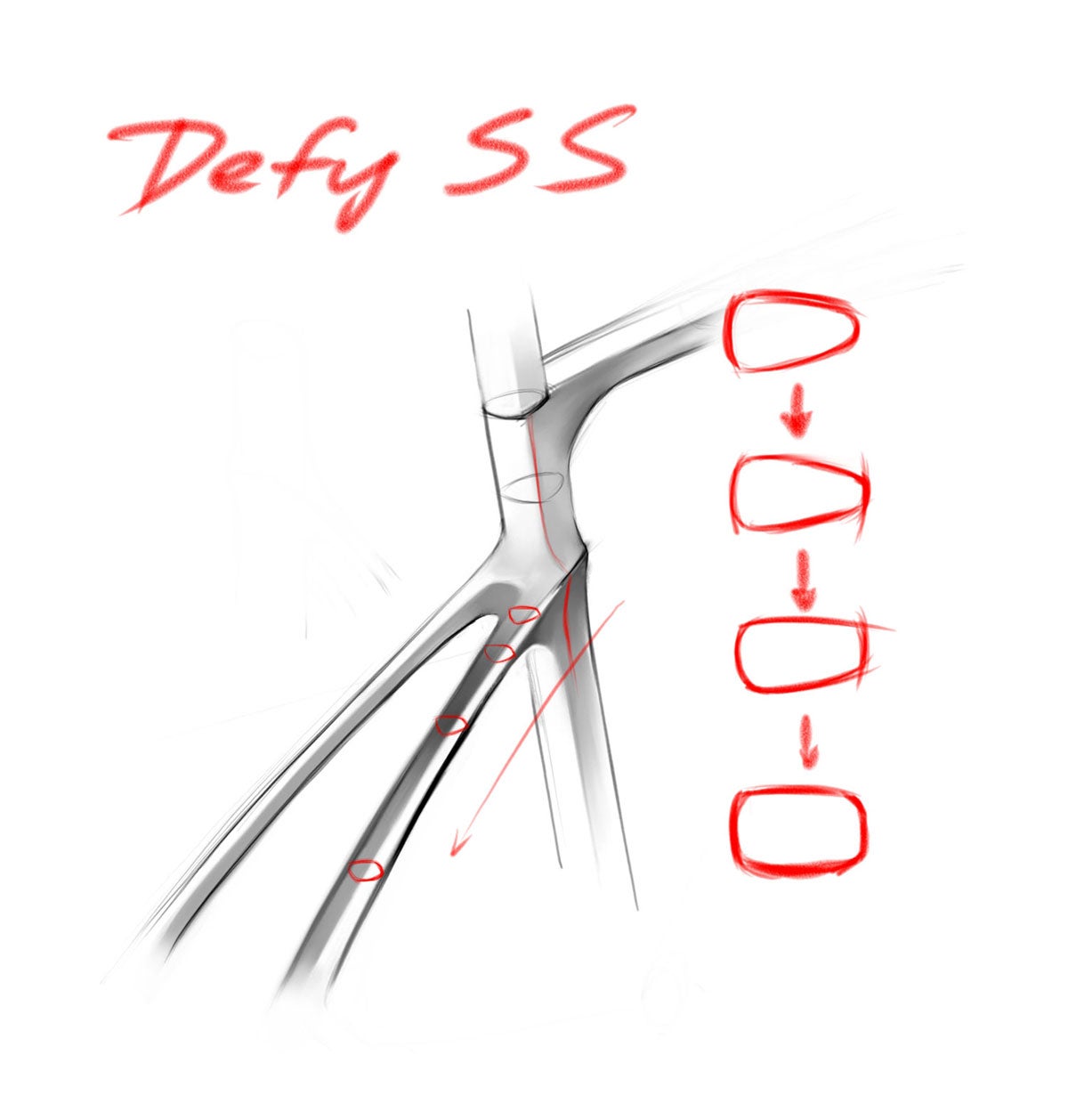

All the new frames also utilize dramatically thinned compliance-enhancing seat stays, which attach lower on the seat tube. Ride feel is further enhanced by the stock 25c tires, and Swanson says 28s are no problem.
"The stays are basically as thin as we can possibly make them while keeping them hollow," explained Swanson of the leaf spring design. "By keeping the stays hollow and eliminating the need for a brake bridge, we get vertical compliance without sacrificing stiffness. Lowering the junction point gives the frame balance. The upper half of the bike is compliant, the lower half maintains stiffness."

Giant also opted for traditional quick releases rather than thru-axles. Swanson said this was both a weight saving measure, and a nod to the wait-and-see approach the company is taking toward the increasing use of disc brakes on road bikes, but the lack of an established standard when it comes to axles.
"People will say that once in a while you can get your rim brakes to hit your wheel so wont the same thing happen with rotors," explained Swanson. "But that's a wheel issue, not the core axle assembly. When there is an industry standard that goes beyond a couple third party players, and there are the same tolerances with the same designs, then we'll go with that. But at this point I was not comfortable building a product that would lock someone in to a limited number of wheels."

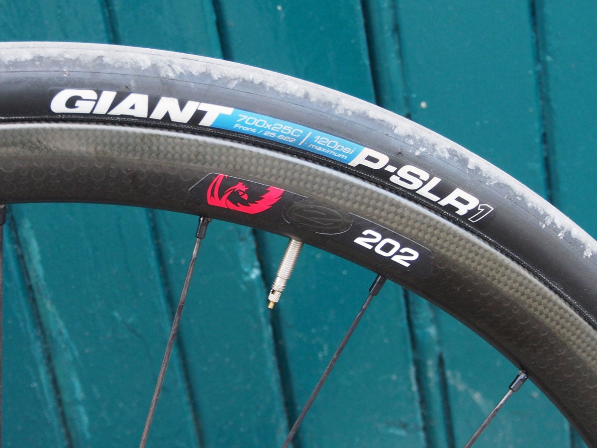

Bikes come stock with 25c tires (pictured) and are rated for 28c max. But you might be able to sneak a 30 in there. The headtube and fork integrate nicely.
Swanson did admit that moving to a thru-axle would have allowed for less material in the fork, and speculated that eventually 12mm will become the industry standard.
"Right now there are multiple conversations happening between a few of the big brands and everyone is talking the same talk," he said. "If it was up to me it would be done by now. But we still need the collaboration of the big brands to come together. I think 12mm is a good number. It's a number that gives enough stiffness that you can remove material from the fork leg, and I think 12mm thru-axles can be made light and still be stiff. But no matter where we end up, it also needs to have true quick release functionality so you can get wheels on and off quickly."
