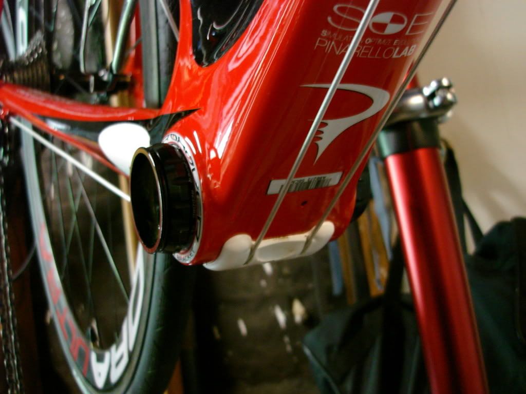

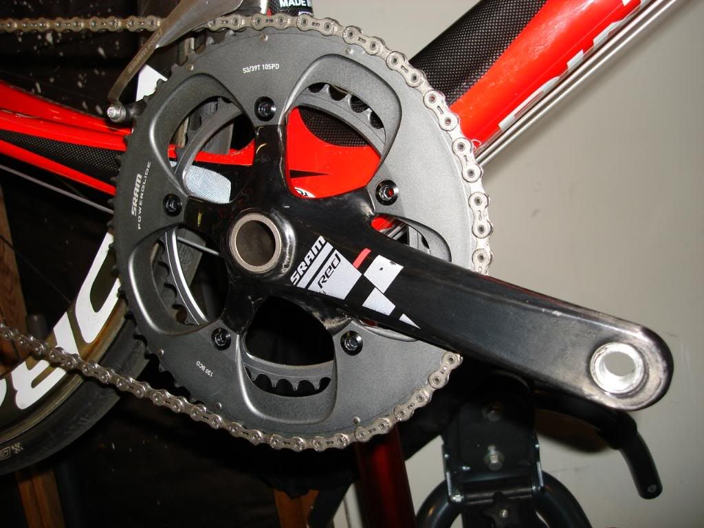

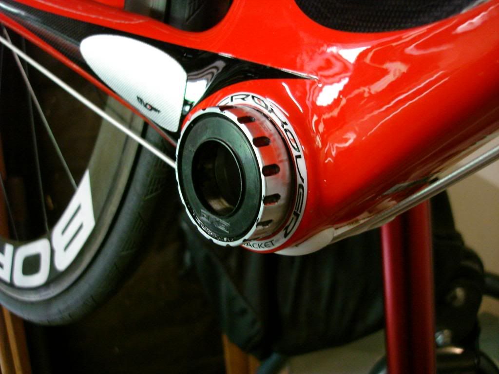

I just switched out my SRAM Red crankset for the new Fulcrum Racing Torq RRS crankset so I thought I'd share my experience with anyone interested.
Objective: Increase stiffness and lose a little weight in the drivetrain.
Tech: Both cranksets utilize multi-directional C/F hollow tech crank arms with outboard bottom bracket cups using high grade ceramic bearings. The new Fulcrum RRS crankset is the same spec as the the 09 Campy Super Record Ultra Torque with CULT Technology ceramic bearings. Both cranks include high efficiency Hard-Ox anodisation treatment for the chainrings. I opted for the Campy Super Record BB cups because they are hard anodized which give them a nice steathy black finish.
Weight: (Crankset & BB cups/berrings)
SRAM Red - Claimed: 756 grams / Actual: 757 grams (175mm)
Fulcrum RRS - Claimed: 696 grams / Actual: 694 grams (175mm)
Results: Noticably stiffer, lighter (-63grams) with smooth shifting from ring to ring.
Pix below.
