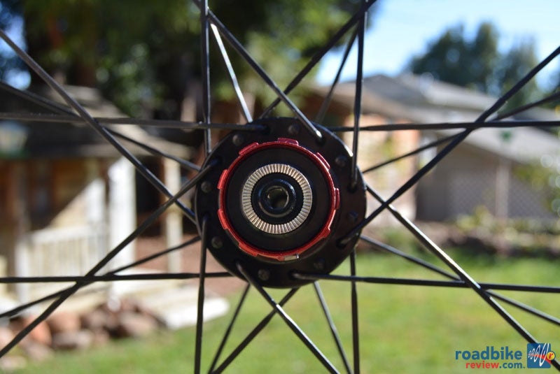

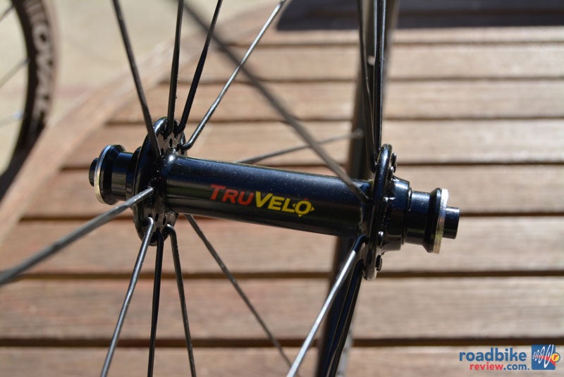

- 20/24 spokes with standard j bend spokes (easy to maintain/replace spokes if needed)
- Precision bearings
- 6 pawl free hub for quick engagement
- Steel spline insert on free hub body to prevent cogs from galling into alloy free hub body. (Galling is a problem if you switch cassettes out a lot.)
- Tubeless ready (to convert: requires sealing rim tape, and sealant)
- Spoke tension is equal on drive and non drive - makes for lateral stiffness in cornering and a lively "snap forward" quality during acceleration.

To be frank, I had low expectations with this wheelset. They are OEM, after all? But boy, was I pleasantly surprised. This wheelset has a very responsive ride; they are vertically stiff and the rear hub engages quickly for rapid acceleration. They truly give the feeling of shooting forward instantly. And while I certainly don't have wind tunnel data, the 33mm tall rim height cuts a a more aero path than a typical 24mm high rim. The best part? The hubs were virtually silent. The quick releases weren't exactly visual works of art but they clamped down with secure power.
