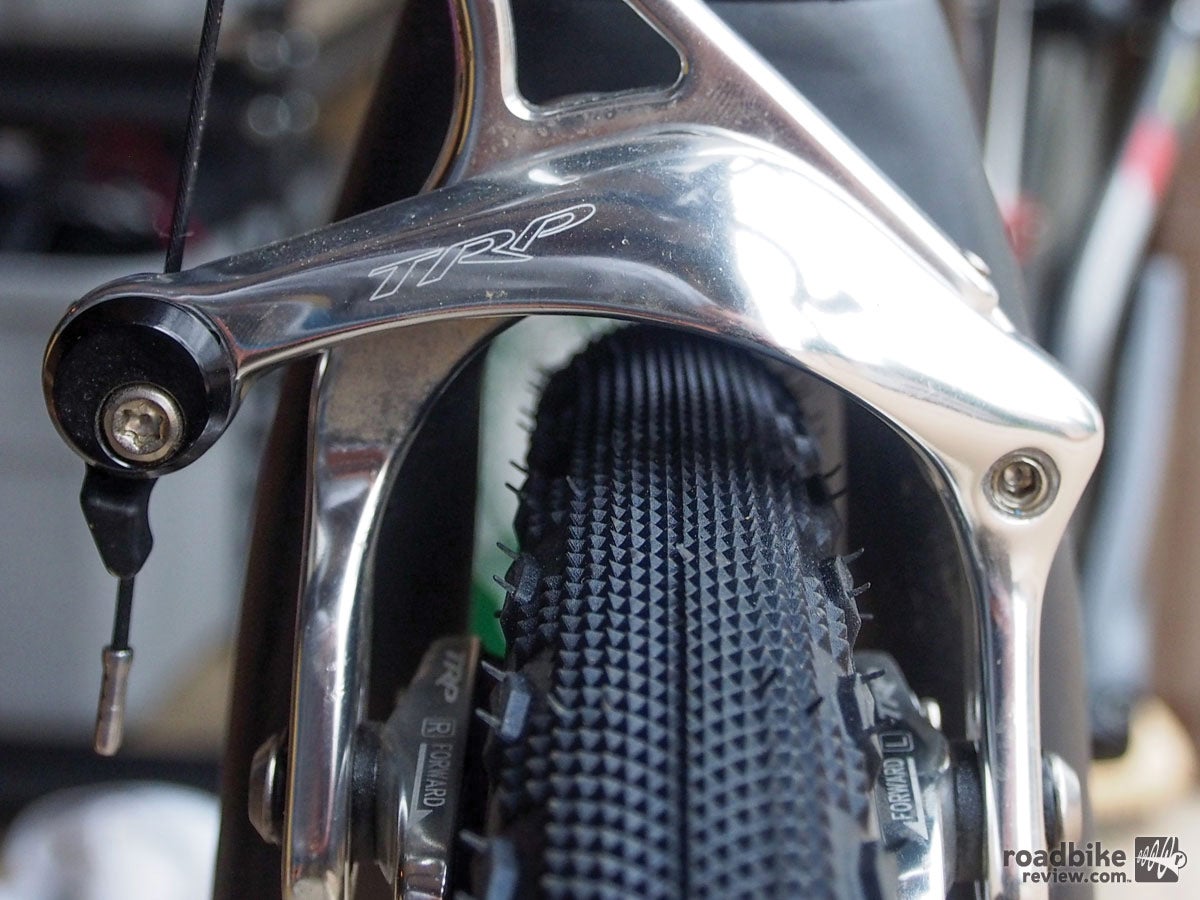

In the plus column was the Xenith Endura Elite's unique spec, highlighted by a set of dual-pivot, long reach TRP RG957 brakes, which put this bike at the top of the test for max tire size compatibility.
While the bike comes with a set of Vittoria Rubino Pro 25s, Jamis claims the Xenith Endura Elite will accept up to a 34c file tread rubber without fenders, or a 28c tire with fenders (hidden fender and carrier mounts are stock on the frame). We tested that claim with a set 32c Vittoria Cross XN Pro tires that measured about 31mm, and as you can see in the photos below, they fit with plenty of room to spare. Safe to say you could squeeze a 34c in there if you wanted.
The Jamis Xenith Endura Elite had no trouble handling wide tires - and we could easily have gone wider.
"The choice to spec those long reach brakes shows that someone really thought about how this bike would be used," said one tester with a particular proclivity for taking road bikes off road. "It's a great example of manufacturer responding to the needs of the market, as opposed to just saying, here's a bike, hope it works for your needs."

And of course, the 11-speed Shimano Ultegra drivetrain drew universal praise for its crisp shifting. However, several testers noted that while the TRP brakes gave the bike more tire width versatility, they didn't work as well as the Ultegra brake calipers found on some other bikes in this test.
"The [TRP] brakes definitely felt a little spongy at times," said one tester. "There was a noticeable difference when compared to the Shimano stuff. You had to brake earlier and with a little more hand force."

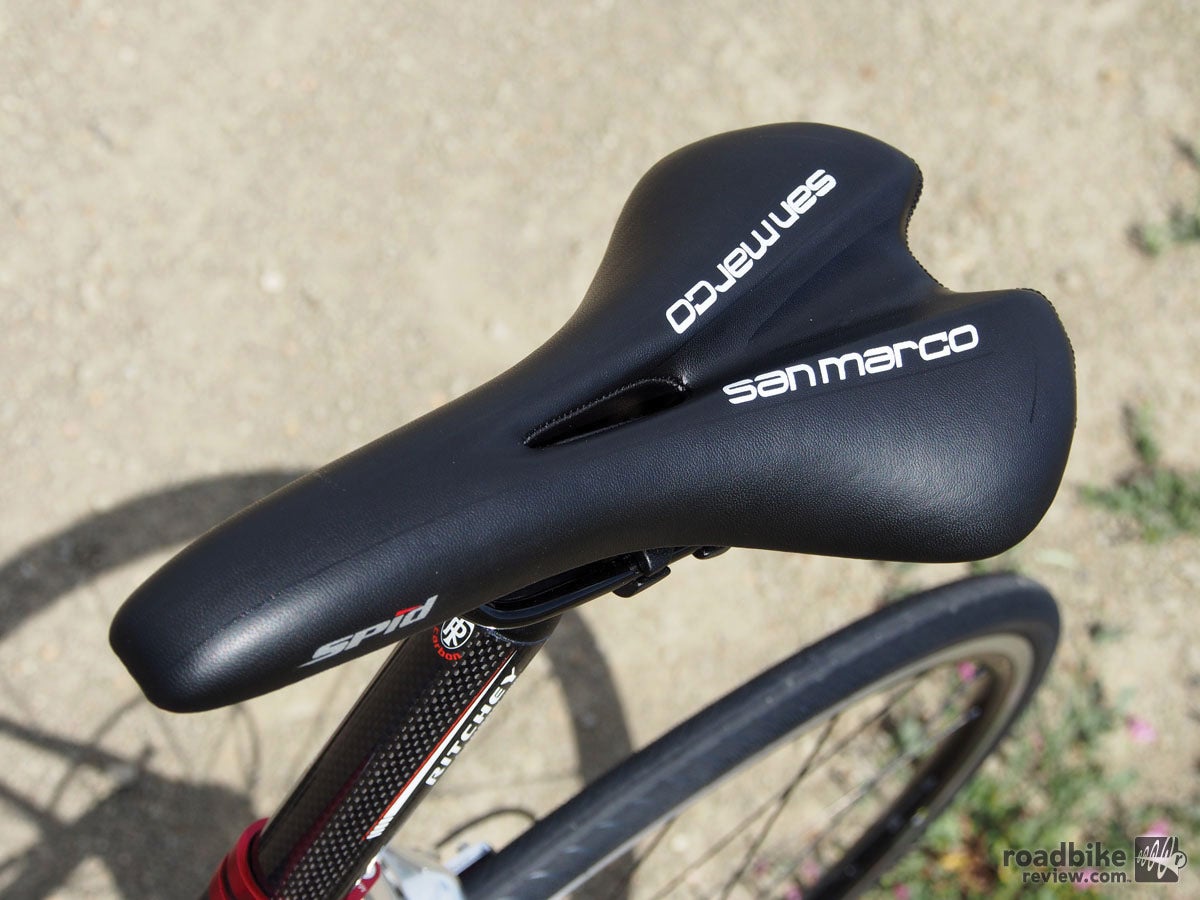

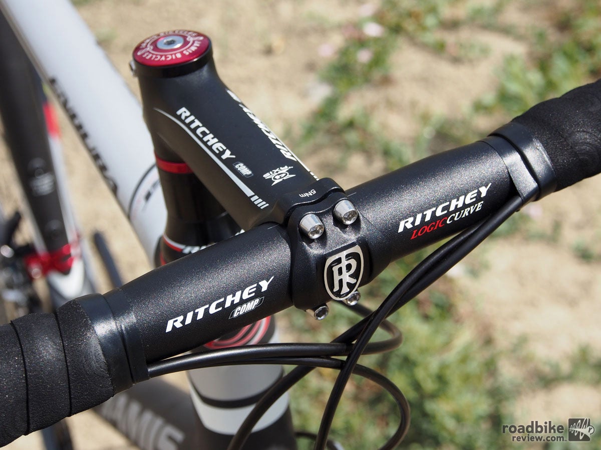

Attached to the frame is a serviceable mix of components, highlighted by a Ritchey Comp stem and Ritchey Comp Logic Curve handlebars, with short reach (73mm) and shallow drop (128mm). A Ritchey Carbon Pro seatpost is topped by a San Marco SPID saddle, which some testers felt was a little "too comfy."
"It's all personal preference when it comes to saddles, but for me it almost felt a little bouncy," said one tester. "It was to the point where it interrupted my pedaling. I would definitely swap it out if I bought this bike."
